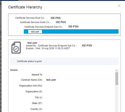

okay so below is an example of a cert that was issued to a user's byod device. you can see it was issued by the PSN and signed by root CA which is the PAN. I read that apple iOS devices wont trust the cert unless its signed by a well known CA. So my question how can the PSN have the cert it issues to byod devices be signed by external root CA, instead of the PAN?

Here is another great article
https://www.networkworld.com/article/2225032/infrastructure-management/what-are-wildcard-certificates-and-how-do-i-use-them-with-ciscos-ise.html
The certificate that resides on the PSN isn’t issued to the BYOD devices. It is used when setting up the trusted communication between the PSN and the device. Not only will you need to apply It to the portals but you will also need it for EAP
