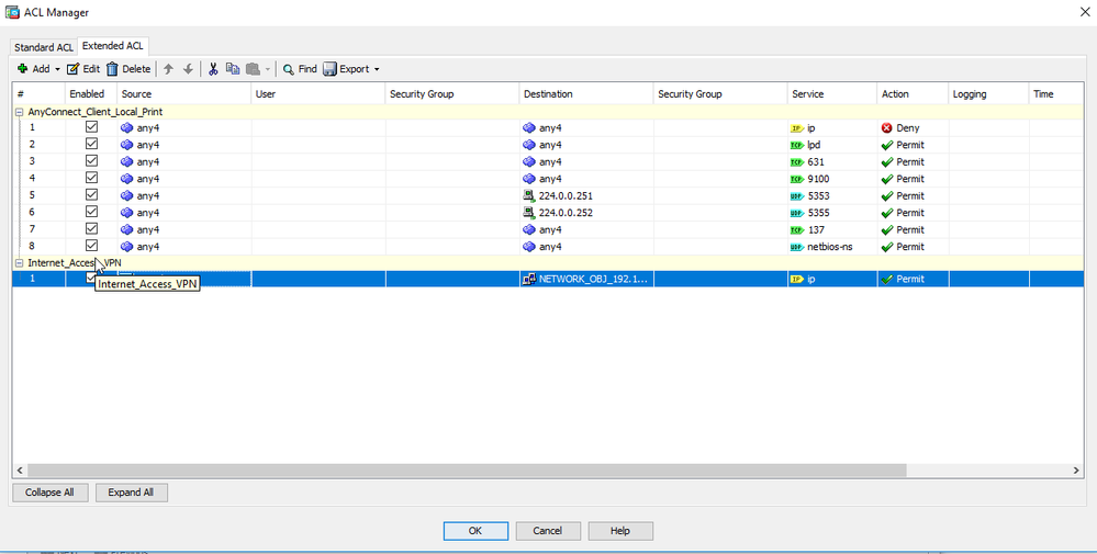

Thanks for posting the configuration. There are probably some issues which I do not understand very well yet. But I would like to start with these.
You identify that you would like a VPN user to access the Internet using the ASA. This means that an IP packet from the VPN user would arrive on the outside interface and you want the ASA to forward that packet back out the outside interface to access the Internet. This function is sometimes referred to as hair pinning. And by default the ASA does not support hair pinning. To enable this you need to permit same security level intra interface. The syntax would be
same-security-traffic permit intra-interface
You identify that the Guest wifi (dmz1) can access the Internet but the other dmzs can not. The reason for this is that you have configured an address translation for dmz1
nat (dmz1,outside) after-auto source dynamic any interface
 but you have not configured any address translation for the other dmz interfaces. If you want the other dmz to access outside then you need to configure translations for them.
In addition to these things I would like to point out an issue with your access list
access-list AnyConnect_Client_Local_Print extended deny ip any4 any4
This beginning statement is followed by a number of statements permitting various types of traffic. But since an access list is processed in sequential order the effect of the first statement is to deny all traffic and none of the other access list entries will be processed. I do not see any reference to this access list in the config and so the access list may not have any impact. But if you are trying to use this access list you should correct this logic.
If there are other issues which you would like to address then please provide clarification about what these issues are.

To Paul and all the others, I am very sorry for the delay, but here is the running config as for now.
The two most important things that I would like to achieve are
 1) Allow VPN users (AnyConnect and IPSec) to access the Internet via the ASAs internet connection
 → Example: ASA is in Japan, I travel to another country, connect to a cafe's Wifi and establish an IPSec connection from my mobile phone. I can access the server at home but no internet. And I would like the phone to use the secure internet connection at home and not the cafe's potentially unprotected one. I search on the net suggested that
crypto isakmp nat-t
should solve this issue but unfortunately it doesn't.
2) As you can see from the running config, there are a few DMZs now. Currently the guest WiFi can connect to the internet. Which is good. The inside interface can connect to the DMZs. Which is good too. Now the newly created DMZs can not connect to the outside. I remember that I had to create a rule, an object, or whatever it is named in Cisco language to make that happen for the DMZ in which the guest WiFi is located. Before creating the other DMZs, most VMs were actually in the this DMZ which had a connection to the outside. But this caused troubled when I tried to remote into this VM as explained in the opening thread. So the choice was either allow connection to the outside or allow internal connection (from VPN to VM) but not both at the same time.
OK, long story. Here's the run-config of the device:

3.[The IPv4 Deny rule - OPEN]
I found it on the system but I still don't know what it is for nor do I know how it got there.
I do have checked a box on the guest Wifi DMZ which says block traffic to inside interface. Guest Wifi is just what it says, just a connection to the internet and it doesn't require access to other networks.
Could it be possible the rule derives from this setting? Otherwise I have no clue. Can you teach me how to safely remove it if it's not used anywhere?
I have found many configurations for ASA that have this access list and assume that there are some Cisco configuration examples that have this access list and I assume that someone in configuring your ASA included this access list (and they added the deny any4 any4 statement which is not usually part of the config as I have seen it in other references).  224.0.0.251 port 5353 is documented as being for multicast DNS and 224.0.0.252 port 5355 is documented as being for Link Local Multicast Name Resolution. I am surprised that removing these objects disables VPN access but especially if this is the case I suggest that you leave those objects in the config and not worry about them.
I believe that the access deny rules that you ask about are not really the result of your checking the box to deny traffic from wifi dmz to inside. They are there because they define the default behavior of the ASA. That behavior is that a packet received on an interface which is going to a lower security level interface (for example coming into inside interface (security level 100) to dmz (security level 50) is permitted but that traffic going to a higher level interface (for example from dmz (security level 50) to inside (security level 100) would be denied. You should not attempt to remove these rules.
