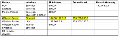

I'm having trouble routing my 192.134.0.0 network to my server (104.33.110.110) using the WRT300N's advance routing tab. I tried adding a router in between my server and wireless router but still couldn't figure it out.
Am I missing something or is there some other way to do it?
Thank You!
Edit: I'm using WRT300N as a dhcp server and connecting it to the wireless devices.

My network consists of an external server called cn.com(104.33.110.110), 30 wired connection and 60 wireless connections(both have a default gateway of 192.168.0.1 and receive DHCP from the wireless router).
The problem I'm facing right now is I can't seem to find a way to route 192.168.0.1 to 104.33.110.110 to let them be able to ping each other.
