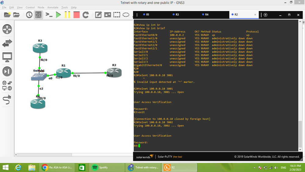

This is lab as my friend  @Joseph W. Doherty request
I using same IP to access R3 and R4 via telnet rotary 3001 and 3002
hostname R1
boot-start-marker
boot-end-marker
no aaa new-model
no ip icmp rate-limit unreachable
ip cef
no ip domain lookup
no ipv6 cef
multilink bundle-name authenticated
ip tcp synwait-time 5
interface FastEthernet0/0
ip address 100.0.0.1 255.255.255.0
ip nat outside
duplex full
interface FastEthernet1/0
ip address 10.0.0.1 255.255.255.0
ip nat inside
speed auto
duplex auto
interface FastEthernet1/1
no ip address
shutdown
speed auto
duplex auto
interface FastEthernet2/0
no ip address
shutdown
speed auto
duplex auto
interface FastEthernet2/1
no ip address
shutdown
speed auto
duplex auto
interface Serial3/0
no ip address
shutdown
serial restart-delay 0
interface Serial3/1
no ip address
shutdown
interface Serial3/2
no ip address
shutdown
interface Serial3/3
no ip address
shutdown
interface GigabitEthernet4/0
no ip address
shutdown
negotiation auto
ip nat inside source static tcp 10.0.0.3 23 100.0.0.10 3001 extendable
ip nat inside source static tcp 10.0.0.4 23 100.0.0.10 3002 extendable
ip forward-protocol nd
no ip http server
no ip http secure-server
control-plane
line con 0
exec-timeout 0 0
privilege level 15
logging synchronous
stopbits 1
line aux 0
exec-timeout 0 0
privilege level 15
logging synchronous
stopbits 1
line vty 0 4
login
end
R1#
I don't believe this will support what the OP is trying to achieve, assuming I correctly understand what OP is trying to achieve and also assuming I correctly understand what you've done.
For starters, although OP didn't discuss port usage (or only using telnet), I've been presuming OP wants to access multiple hosts, using different IPs, but using the same port numbers.
For example consider:
testing system <> system being tested
Where the testing system is just one physical system, but the systems being tested are multiple physical systems, all using the same IP (and possible same app ports).
Your approach, mentioning using a dialer, started me wondering whether VRFs might be used.
We can certainly have multiple systems being tested, each in their own VRF, using the same IP.
Might it be possible we could map a single testing system to appear with different IPs (NAT) then PBR to a different VRF based on testing system NATed IP?
I don't know the answer.  Not something I've ever tried, especially if we're limited to one Cisco device, but perhaps with two?
E.g. testing system (192.168.1.1) <inside> RTR[NAT] <outside> (192.168.2.1..254) <PBR> L3SW <VRFs> (1..254) systems being tested (192.178.20.6)
 so that I can access the devices from outside <<<- he mention that he want access device from outside, I take telnet as example.
you can do same for SSH instead using known port you can use any port and in the NATing router you will NATing the unknown port to known port for specific device
for VRF he dont mention using VRF, and from my experience there is some bug of using static PAT with VRF.
anyway if he want also VRF I will try lab it if my router image support static with VRF aware.
