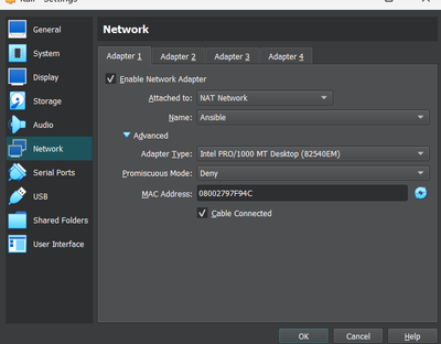

There are no cdp neighbors in the output. I'm using VirtualBox
Ok. Then I believe there is a problem with the networking configuration on your VirtualBox. Can you share a screenshot of the networking configuration for the linux vm?
Regards, LG
*** Please Rate All Helpful Responses ***
These are the NAT adapter settings
I would change the settings for the first adapter - Attached to: Bridged Adapter.
This way you are sure that your vm is in the same vlan as the switch management vlan. I presume that the PC you are running VirtualBox on is attached to the switch on the first port - interface FastEthernet0/1.
