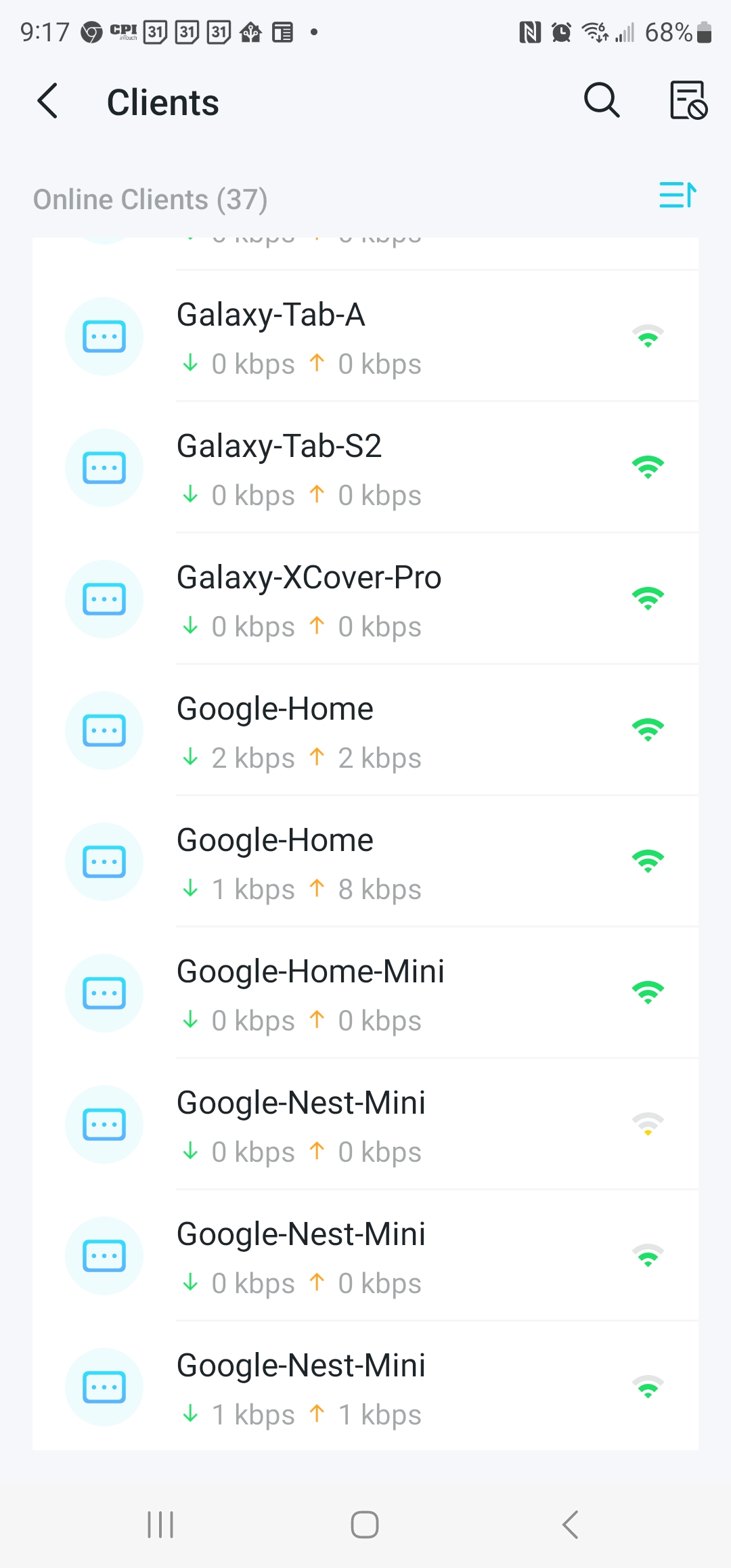

hmmm, so the client name for the static clients work, I can ping them via ip or hostname and they reply, the dynamically assigned ip addresses seem to be the problem. The other thing I noticed (see screenshot) is that the clients all have hostnames on the wifi client list (downstream from the switch) but not on the switch itself. This is after they've all gotten ip addresses allocated by the switch.

I’m not sure where you want to see those hostnames of dynamic DHCP clients. My CBS350 switch does not show any hostnames in its address binding list and I don't expect them to be there. Although the CBS350 and the SG350 seem to be very similar, their WebUIs are different.
My APs, TP-Link EAP, show hostnames if dynamic DHCP clients send them. Again, not all them do that and some of them just send hardcoded names. My old ASUS routes made it possible to overwrite those hostnames, but my current APs do not. Fortunately, I can use an optional controller with those APs that shows an additional field which is called [sic] User Name. That field is populated either with hostnames, if available, or MAC addresses and can be overwritten. If that’s not possible in your Deco, I’m afraid nothing can be done. It is what it is ☹
