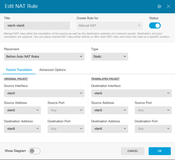

@IgnatAndrei because traffic from one VLAN would be translated behind the FTD interface, unless configure not to.
I cannot see your rules behind to determine if they are conflicting, but you need to define Manual NAT rules as per the example below.
this rule ensures traffic between vlan5 and vlan6 networks are not translated.
Running packet-tracer as requested, would confirm the packet flow through the firewall and confirm my suspicion.
