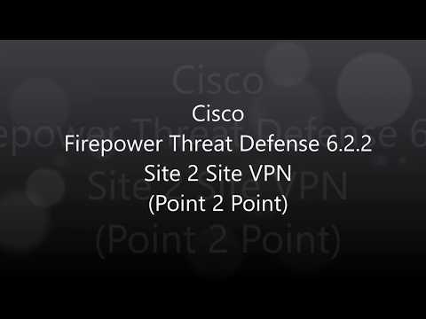

As per the orginal post you have mentioned, all the configuration in place.
2. When Adding Endpoints in the VPN Configuration on the FMC, for Node A(Cisco FTD), Its easy to add the node from the "Device" drop down option, but for Node B(SRX), unable to add the node.
Node B you need to create with SRX  IP,  follow below video :
https://www.youtube.com/watch?v=2ivWnEQfdzU
BB
Cisco Firepower Threat Defense Site-2-Site VPN focusing on Point to Point. This solution is leveraging pre-shared key. https://www.cisco.com/c/en/us/td/docs/security/firepower/620/configuration/guide/fpmc-config-guide-v62/firepower_threat_defense_site_to_site_vpns.pdf
Thanks Balaji, that link was so helpful.
