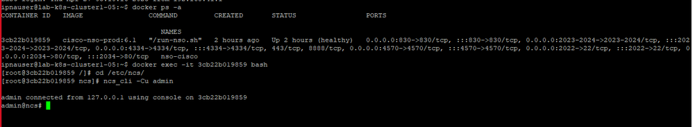

Hi ,I am trying to deploy a docker container in k8s cluster from "nso-6.1.container-image-prod.linux.x86_64.tar". I downloaded this image from cisco. I performed these steps : docker load -i nso-6.1.container-image-prod.linux.x86_64.tar.gz , docker run -itd --name nso-testing2 -p 50130:4334 -p 50131:80 -p 50132:8888 -p 50133:830 -p 50134:4570 -p 50135:443 -p 50136:22  cisco-nso-prod:6.1
so once I perform those commands the container is up and running but I am not able to access the UI or not able to ssh.
Please suggest what is wrong and how to deploy the container successfully ?
Attached the nso guide , please refer page no - 168 for clarity.

How are you trying to access the UI and SSH? You need to use the ports exposed, for example port 50026 to reach the container's SSH port (22) and port 50021 to reach the UI port (80).

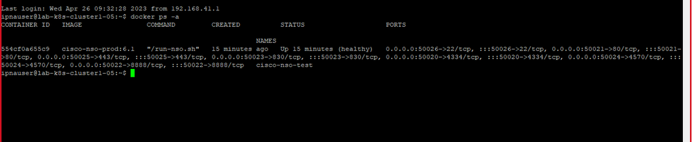

Hi, you can see in the attached image the 50021 is exposes to 80 , hence I should be able to reach the UI with this url- http://10.248.14.122:50021. but not able to reach. Also not able to ssh with 50026. attaching the screen shot.image.png
jvikman
Great, then you are using the correct port. Can you access the interactive shell on the running container?
docker exec -itnso-testing2 bash
Yes I am able to access the interactive shell and i am able to access ncs console. But not able to access from browser.image.png

Hi, Seems the ports are open. please find attached screen shot and also attaching ncs and devel logs.
please lead me to the correct direction if I am missing something.

jvikman
The "docker port" command lists the mapping for the container, but doesn't say anything about the status of those ports in the running container.
Can you run the netstat/ss commands in the running container?
docker exec -it <container>
$ ss -lnt | grep 22
or if that fails:
$ netstat -lnt | grep 22
According to the ncs.conf, the webui is configured to listen on port 8080 so change the port mapping of the container to point to 8080 instead of port 80.
docker exec .... -p 50531:8080 ...
[root@bde0282ced02 /]# ss -lnt | grep 22
[root@bde0282ced02 /]# netstat -lnt | grep 22
bash: netstat: command not found
ipnauser@lab-k8s-cluster1-05:~$ docker run -itd --name ciso-nso667 -v /data/nso:/nso -v /data/nso/etc:/etc/ncs -v /data/nso-logs:/log -p 50001:4334 -p 50002:8080 -p 50003:8888 -p 50004:830 -p 50005:4570 -p 50006:443 -p 50007:22 cisco-nso-prod:6.1
19340e1be5dd4038b73098811ce5a4db9660c2c2a0d3e7789e8c86ab0d4577a3
ipnauser@lab-k8s-cluster1-05:~$ docker ps -a
CONTAINER ID IMAGE COMMAND CREATED STATUS PORTS NAMES
19340e1be5dd cisco-nso-prod:6.1 "/run-nso.sh" 5 seconds ago Up 4 seconds (health: starting) 80/tcp, 0.0.0.0:50007->22/tcp, :::50007->22/tcp, 0.0.0.0:50006->443/tcp, :::50006->443/tcp, 0.0.0.0:50004->830/tcp, :::50004->830/tcp, 0.0.0.0:50001->4334/tcp, :::50001->4334/tcp, 0.0.0.0:50005->4570/tcp, :::50005->4570/tcp, 0.0.0.0:50002->8080/tcp, :::50002->8080/tcp, 0.0.0.0:50003->8888/tcp, :::50003->8888/tcp ciso-nso667
jvikman
Right, there's no SSH-server installed so there's no one listening on that port in the container. You can install that yourself if you need it.
And as for port 80, no one listening on that either because the default port is 8080. Here you can change the port mapping as I suggested earlier or you can change the ncs.conf.
If you want you can use another ncs.conf you can mount in an ncs.conf using "-v" with docker.
Mount the ncs.conf you want to use into /etc/ncs/ncs.conf or /nso/etc/ncs.conf.
Note that there is an example that does not mount ncs.conf or share a volume with the docker host. See https://gitlab.com/nso-developer/nso-examples/-/tree/main/deployment/netsim-sshkey. If the docker image is loaded, just run the "./setup_ncip.sh". Please have a look at the README for details.
