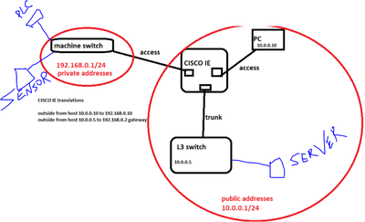

hello,
could someone confirm that it shouldn't work , or am I wrong ?
I have CISCO IE which is translating private addresses ( machine network ) to public ( common network ) .
Common network is VLAN 10, so access port are assigned to this VLAN, and on trunk is this VLAN too .
whenever I put on trunk ->  l2nat NameOfInstance 10
then I lose connectivity from this VLAN 10 to PC, but when I have device connected to L3 switch in this VLAN 10 it is working well, what is happening on CISCO IE when I put this l2nat NameOfInstance 10 ?
Could someone explain ? should it work or not  ?
(I didn't include translations from private in example )

thank you for answer, but we want use 1:1 NAT , so we have to translate each device which should be visible in public network,  and each device which should be visible in private is translated too, when we connect this PC to L3 switch everything is OK, I suppose that due to NATing on CISCO IE , we shouldn't connect there device which is defined in translations .

we have plenty installation with 1:1 and everything is working fine, like in this scenario :
