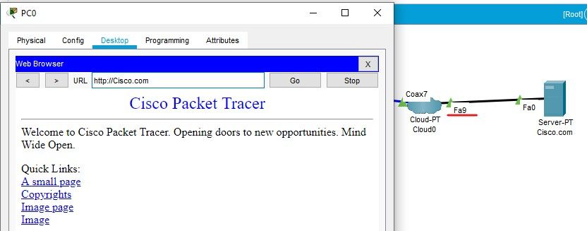

I have went through this exercise/lab various times, and I keep having the same problem, in which when I ping Cisco.com, I get a message saying "Ping request could not find host Cisco.. Please check the name and try again". I would appreciate if anyone could help.
Hi @YatinVij
Currently, the server is connected to the Eth6 interface of the cloud:
But your cloud connection points to the Fa9 interface:
To correct this you can change the cloud connection to the Fa9 interface:
After that change, connectivity is successful:
Regards

Hi @YatinVij
Compress your exercise (winzip) and attach it to check.
Regards

Hi @YatinVij
Regards

Hi @Khadkay
I have checked your exercise and you must make two changes:
1-Go to the cloud > config > cable and remove the current connection
Replace the Ethernet6 interface with the FastEthernet8 interface and add that new connection
That connection should look like this:
Regards
Remember to mark the correct answers as solved, because that helps other users with similar doubts.

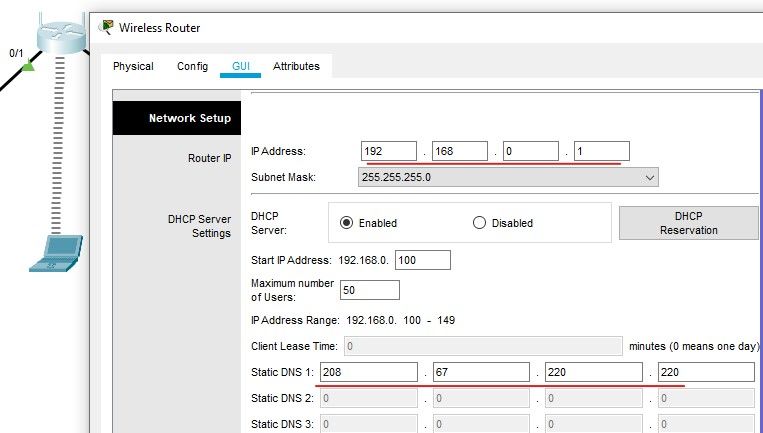

Hi @Khadkay
The second change is made on the wifi router
2-Go to the GUI tab of the router and change the IP of the router (for example the IP 192.168.0.1/24), also assigns the server IP as DNS (208.67.220.220)
Save the changes
Now go to both PCs and renew the DHCP request (click static and click DHCP)
After these changes, connectivity is successful.
Regards
