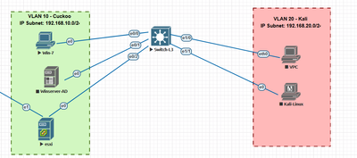

Hello, I am trying to configure a FOG imaging server in the EVENG topology, and FOG needs to load window 7 through the PXE boot, In topology ESXi is the FOG server and I want it to take the image from window 7. However, to take the image from window 7, the window 7 machine needs to be booted from the network. My question is can I boot it only with a
switch or do I have to use a router as well?

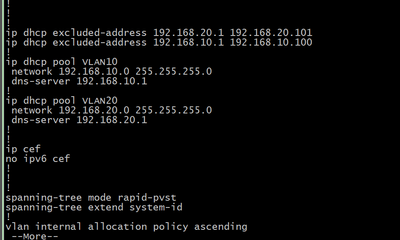

Never tested in eve-ng or PNET for this requirement.
But you need multicast enabled on switch with ip helper address for PXE boot.
example :
interface VlanXXXX
ip pim sparse-dense-mode
ip helper-address XXXXXXXXXXXXX (PXE Server IP)
