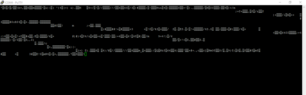

I booted up the router to try input the set command but now it is stuck on this screen. This output is straight from powering on.Capture.PNG
I have fixed the other issue by changing the baud rate, here is the result for the set command.
