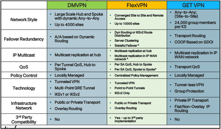

Attached compare between the different technologies:
https://www.ciscolive.com/c/dam/r/ciscolive/us/docs/2018/pdf/BRKRST-2309.pdf
DMVPN is use for IP reachability between sites and also secure data.
since you have MPLS which cover the IP reachability then you need only them secure the traffic which done by GETVPN.
for DMVPN with hub lost connection issue ,GETVPN with KS have same issue.
