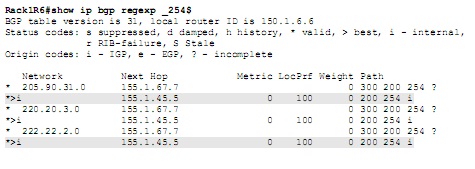

Here is a printscrint of the output, sorry for the screenshot, It's from a PDF and can't copy it.
And yes :P I did it in a rack so it's not a missprint haha, in real devices it does the same thing.
What I'm looking for is some kind of rules as to when does it put a 0. For example, in the output the 67.7 router is a EBGP peer, but ive seen the same think (no MED, or at least not showed) from IBGP peers.
thanks in advance!
Hello Omar,
by looking at your sh ip bgp example we can make some notes:
advertisements with MED=0 are the result of the usage of network command on originating router.
We can notice the origin code i (rightmost character in the line).
instead the lines that refer to advertisements with a missing MED attribute have origin code ? so they are the result of redistribution into BGP of another routing protocol (or connected or static).
Here best paths are chosen based on the shortest AS path (> symbol).
Hope to help
Giuseppe
