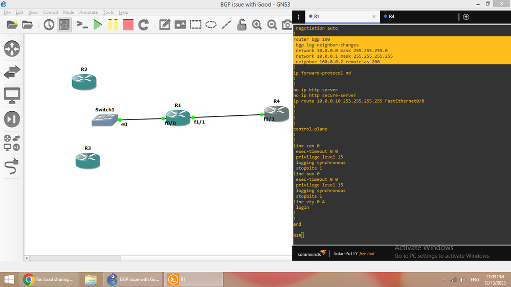

in R1 there are two route one direct and other static with /32 to interface same as direct connect to
it accept as config but it never consider by BGP, the BGP advertise only the /24
I check in R4 and via update
so as I mention before we can not using any filter since R1 never advertise /32 prefix
Note:- I also add no auto summary and same issue
R4 see only /24.
so in any case we can not use R1 control plane to filter traffic
we can do Blackhole  in R4 by adding route to null0 for /32. (this will make any connection to /32 drop whatever it source)
or apply ACL in R1 to deny traffic come form specific source
Hi @MHM Cisco World ,
Please try the configs I provided.
BTW, in your example the bgp network statement (10.0.0.1/32) doesn't match the static route (10.0.0.10/32). This is why BGP doesn't advertise the /32.
