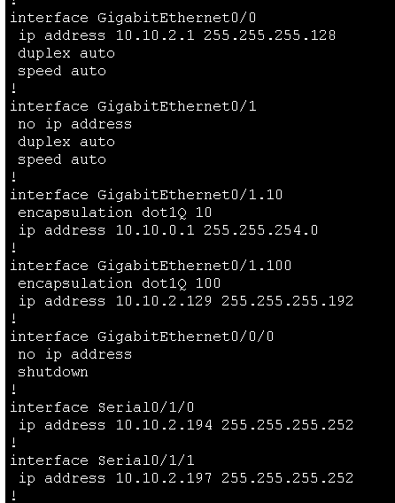

Here is the topolgy the I am working on with specific requirement I have successfully used RIP on Networks 2.128  and 2.0  and Static on 0.0 . Al of the PC's are pingable with each other. But once I set up my vlan on network 0.0  thats allows port f0/24 to give a dhcp ip address from network 2.128 , I suddenly can't ping PCs from network 2.128  to other networks
I notice I can't ping anymore once I do this command
Berlin(config)#int gi0/1.1
Berlin(config-subif)#ip add 10.10.2.128 255.255.255.192
The problem gets resolve when I remove the ip address on gi0/1.1.

UPDATE:
I removed the ip address on Berlin int gi0/1 and instead created a new vlan 10 for the network 10.10.0.0 this what the new config looks likeimage_2024-03-09_172948945.png
 Now my problem is PCs from network 10.10.2.128 can't ping PCs from networks 10.10.0.0, 10.10.2.0, 10.10.2.128 (VLAN 100) . Here is the ip route of Italy Switchimage_2024-03-09_173412056.png
I think I have a routing problem and I don't know how to resolve it. Here is my updated packet tracer
NOTE: ItalySw1 (Rip) BerlinSw1(Rip) BerlinSw2(Static)
your IP addressing does not seem to be correct. On the Berlin router you have a subinterface with the same address space as on the LAN interface of the Italy router.
Post the full requirements, so we can check what you are supposed to configure.
If you shut down GigabitEthernet0/1.100 (see revised file attached), you have connectivity.

The goal is PCs from ItalySw1 must be configured as RIP routing and BerlinSw1 must also be configured as RIP routing while in BerlinSw2 it must be static. Also on BerlinSw2, the laptop is with the same organization as ItalySw1, so when the laptop request a DHCP, it must be given an ip address from the network 10.10.2.128
This is why GigabitEthernet0/1.100 has the ip address of 10.10.2.129 255.255.255.192 so that it can give the laptop in BerlinSw2 a DHCP address from network 10.10.2.128
I thought of an idea, can't I just use Italy as a DHCP server to cater BerlinSw2 port fa0/24 the ip from 10.10.2.128?
Issue is that 10.10.2.128/26 exists in 2 places separated by 10.10.2.192/30 over serial link; Usually ARP mapping will fail. Arp request for net X that is coming from the same net X is dropped by routers; check this before adding static routes.
To fix yr network, remove any static routes u may have; add  on Italia
ip route 10.10.2.135 255.255.255.255 10.10.2.194
and add on Berlin
ip route 10.10.2.131 255.255.255.255 10.10.2.193
ip route 10.10.2.130 255.255.255.255 10.10.2.193
This would mean that DHCP pool must have reservation for Laptop on right to have 2.135 always and for every new PC on left u would need to add static route to reach laptop .135. on Berlin.
Regards, ML
