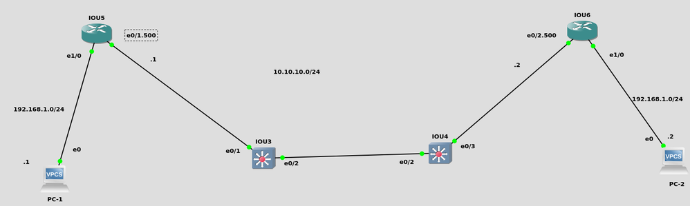

Cant ping b/w hosts with same network segment , IGP is OSPF used
Cant ping between hosts PC-1 (192.168.1.1) to PC-2 (192.168.1.2) /24 subnet  , how can i able to ping in the same network segment b/w these hosts ?
IOU5

You cannot have the same IP subnet (192.168.1.0/24) separated by another subnet or subnets (10.10.10.0/24) as that will not work.
Just change one of the PC subnets to 192.168.2.0/24 and as long as your routing is setup correctly it should work.
Jon
Thanks , but i do that change alredy and it work , but my point is like l3vpn where we make a entire same subnet b/w different same mostly Private ASN , then can it is possible in this scenario.
Like if i have multiple sites for example and want to connect b/w them so a same subnet is not possible , please can tell why for the ospf case .
Please find the pic , for my query .
