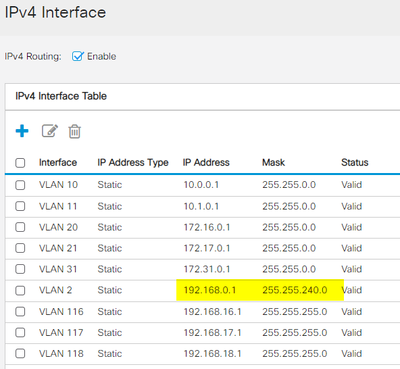

Good day, all. We have a test environment with a handful of CBS350 switches and have been having some routing/ARP issues that I don't quite follow and I'm looking for some guidance to ensure that our managed switches are properly configured.
Our test environment consists of
  • 1 CBS350 48 port switch named Cisco-Main configured with IPV4 routing enabled. Only one configured to route.
  • 1 CBS350 48 port switch named Cisco-Lab.
  • Cisco-Main and Cisco-Lab are connected with a LAG.
  • A dozen or so VLANs are defined on both switches.
  • No static routes are defined.
  • Cisco-Main and Cisco-Lab have ports configured as trunk ports to connect to virtualization platforms.
We have 2 VLANs that handle supernetted IP ranges.
  • 192.168.0.0/20 - VLAN 2
  • 192.168.100.0/22 - VLAN 200
On Cisco-Main, in the IPV4 Interface table, each of our VLANs has a static IP address and subnet mask assigned to it. VLAN 2 is a supernet.
Our other supernet.
