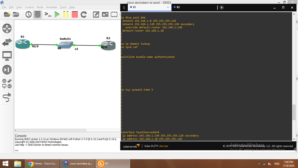

I think you can that' you need to add secondary IP (in interface)
Then add secondary network under same dhcp pool.
Last exclude all primary IP from dhcp pool
If I have time I will lab and share result here
MHM
Hi @Mohamed246
check this lab how you can change DHCP network using the secondary network under dhcp pool
