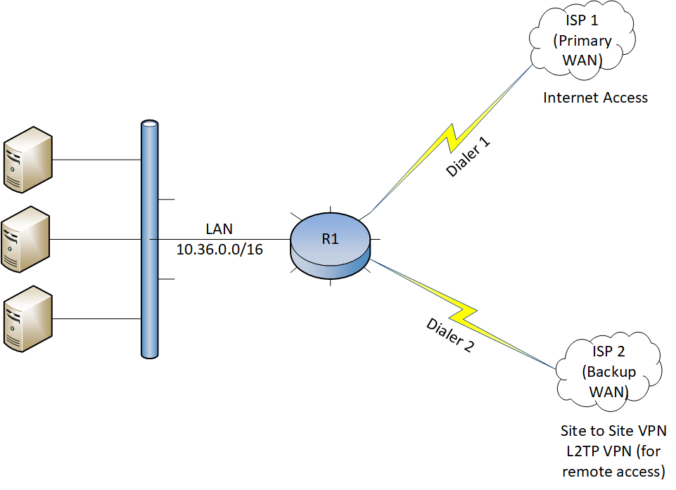

There is a local network (10.36.0.0/16). There is a router (R1), to which two providers were connected (ISP1 (Dialer1) - the main provider, ISP2 (Dialer2) - the backup provider). The network diagram is attached.
ISP1 connection is used for Internet access by users, in addition, access to the mail server is published through it (TCP 25, 430, 587).
Due to the larger channel capacity, the ISP2 connection was given to Site to Site VPN. Also, remote users must connect through it via L2TP VPN.
Configured L2TP VPN on ISP2. But then a problem arose - this vpn works if only ISP1 is in the off state. How can you get L2TP to work without shutting down the first provider? Next year it is planned to connect a third provider and completely transfer all remote access of clients to it. In the meantime, I want to solve the problem with two providers.
Have you encountered a similar decision? The current config is attached.
Perhaps this problem can be solved using PBR, but I can not find a suitable configuration.
I would be glad for any help!

the reason it does only work when the primary ISP is down is, because of the IP SLA and the tracked route, all routing will go through the ISP1 link, until that link goes down, then all routing will go through the ISP2 link.
I'll need to do some testing, in any case, both links need to be active, so you cannot use the IP SLA...
This can be solved with "local PBR":
ip local policy route-map XYZ
The route-map matches on the L2TP-traffic and sets the next-hop to ISP2.
Hello
Just like to add it is just vpn clients that want policy routed if not then a policy needs to be applied for any internal hosts.
Also this below isnt applicable
no ip nat inside source list NAT-ACL interface GigabitEthernet0/0/1 overload
no ip route 0.0.0.0 0.0.0.0 Dialer2 track 2
Lastly to implement PBR create an extended access-list <sip><dip> and apply it to the lan interface you wish you push via dialer 2 interface.
Example:
ip access-list extended PBR_ACL
permit tcp host 10.36.2.10 any eq www
permit tcp host 10.36.2.11 any eq 443
permit ip 10.36.3.0 0.0.0.255  any
route-map PBR
match ip address PBR_ACL
set ip next-hop verify-availability x.x.x. 1 track 2
or
set interface dialer 2
int vlan 2 /  3
ip policy route-map PBR
kind regards
Paul
