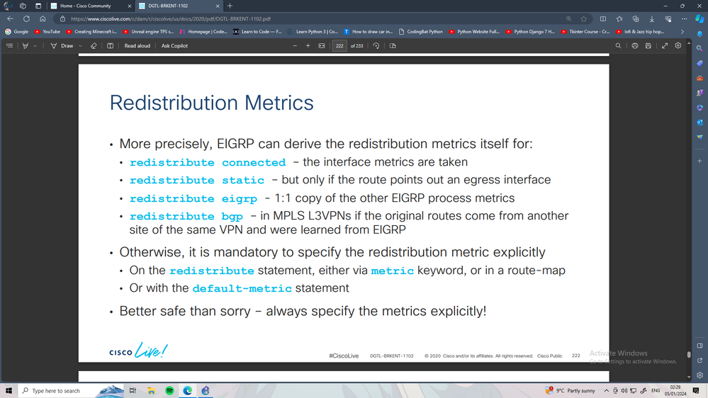

I think I found the reason. As it turns out, if you redistribute static route without any seed metric, EIGRP by default will use delay and bandwidth of the egress interface. As a result, the delay on R1's egress interface out of which the prefix was advertised is 10 microseconds.
Hello
I will agree with @David Ruess the next hop delay of that static route will be calculated.
