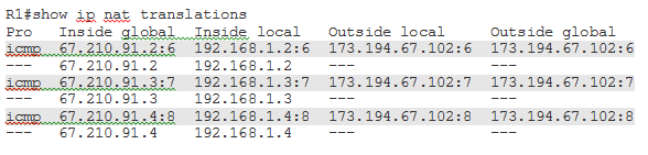

show ip nat translation
there are two entry
one is static
other is dynamic
this dynamic will be in table for timeout "tcp timeout"
when the traffic come from outside
the router will check this table and if the OUT-GLOBAL is appear it will not use IP nat outside
it will use this nat table and hence the ip nat outside failed.
solution use full extend NAT.

I will make you so sure what we need full extend NAT,
clear ip nat translation <- do this more than one times
do ping from outside you will see that NAT is work, since there is no entry in NAT table.
