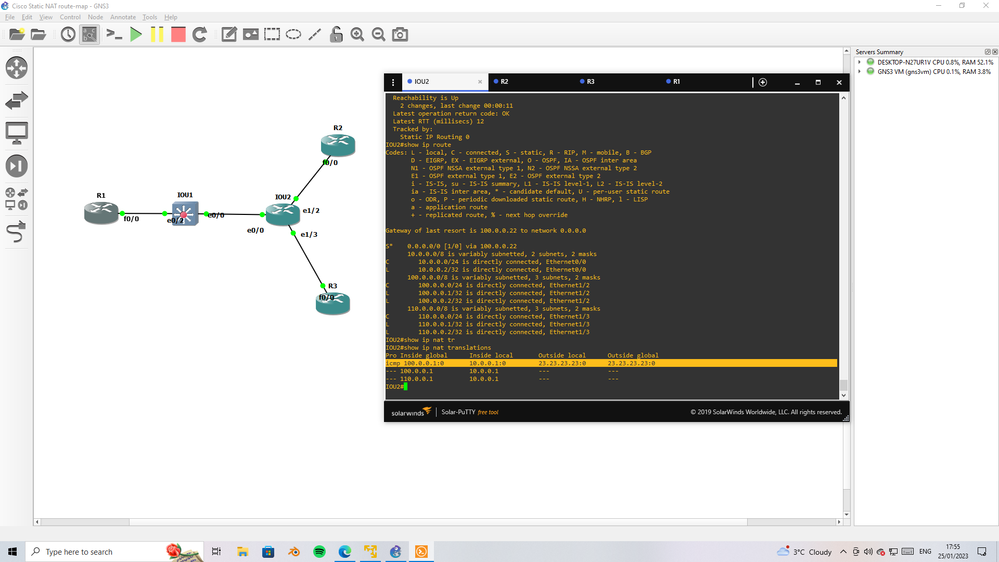

this easy, I will share lab with you today,
but why you mention DMZ in your Q?
Thanks very much !
I speak of DMZ because the firewall does not have a public IP but a private IP... Only the firewall is connected to the router GE0.
IOU2 config
track 1 ip sla 1 reachability
interface Ethernet0/0
ip address 10.0.0.2 255.255.255.0
ip nat inside
ip virtual-reassembly in
interface Ethernet1/2
ip address 100.0.0.2 255.255.255.0
ip nat outside
interface Ethernet1/3
ip address 110.0.0.2 255.255.255.0
ip nat outside
ip nat inside source static 10.0.0.1 100.0.0.1 route-map mhm1
ip nat inside source static 10.0.0.1 110.0.0.1 route-map mhm2
ip route 0.0.0.0 0.0.0.0 100.0.0.22 track 1
ip route 0.0.0.0 0.0.0.0 110.0.0.33 100
ip sla 1
icmp-echo 100.0.0.22 source-interface Ethernet1/2
ip sla schedule 1 life forever start-time now
route-map mhm1 permit 10
match interface Ethernet1/2
route-map mhm2 permit 10
match interface Ethernet1/3
