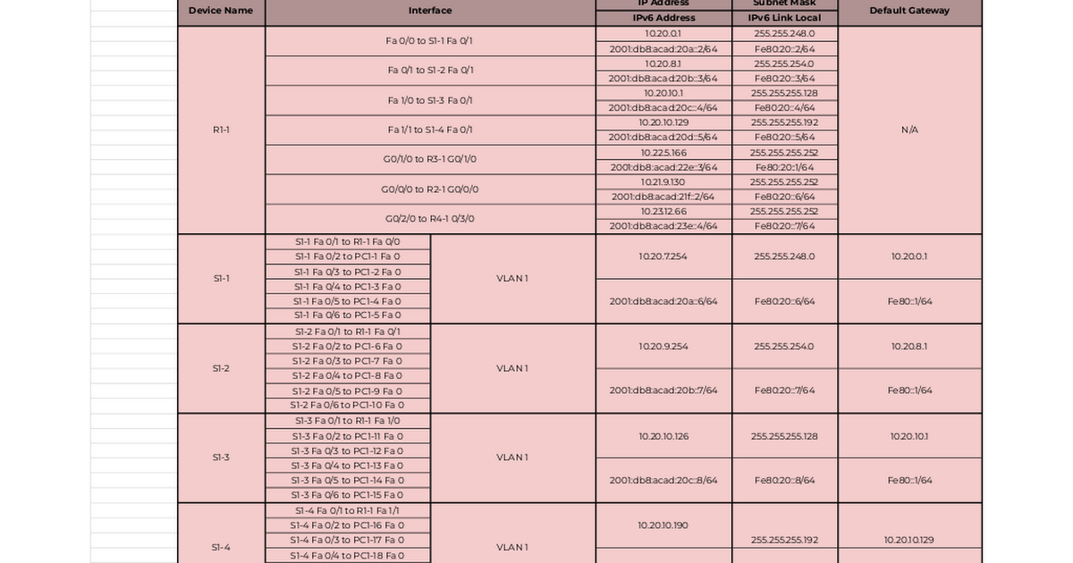

Hiii there,
I'm in a beginner networking course, and my group is struggling with our project. We put together 4 small networks, each connected to the first one which is "HQ".
I'm not sure where we're going wrong with setting up the routing. Using the exact same command, it seems some of the routes don't actually go to the "show ip route" table.
Network #3 (labeled in the packet tracer) can ipv4 ping with HQ (Network #1) and vice versa, but nothing else seems to work. All networks can ipv4 and ipv6 ping within their own networks no problem, so I don't think it's an addressing issue?
Hoping someone might be able to help us out.
Sorry, posted the show run and show ip routes below.
Now I do actually see the routes in show run I guess, so I'm not sure why the pings still fail...would posting a tracert help?

So all 4 routers are 2811s (project requirement) and switches are 2960s. We are trying to use basic static routing. The issue is that when I enter, say, "ip route 10.20.0.0 255.255.248.0 10.21.9.130" which are the addresses for Site #2 to try to reach Site #1 (HQ), I don't actually get an error, but when I "show ip route" it doesn't show up and the pings fail.
Here is show run for HQ's Router:

From R1 are you able to ping below IP address :
10.21.9.129 - YES
10.21.8.1 - NO
10.21.9.65 - NO
From R2 are you able to ping below IP address :
10.21.9.130 - YES
10.20.0.1 - NO
I do not think the no ip cef is intentional. I'm not too familiar with that one, to be honest. I went into both routers and entered "ip cef" and "ip routing". Did another quick testing across sites without luck.
cdp neighbours does appear to be corrects
If it makes a difference, when I try to ping from Site #2 to Site #1, I get "request time out". When I try to ping from Site #1 to Site #2, I get "destination host unreachable".
