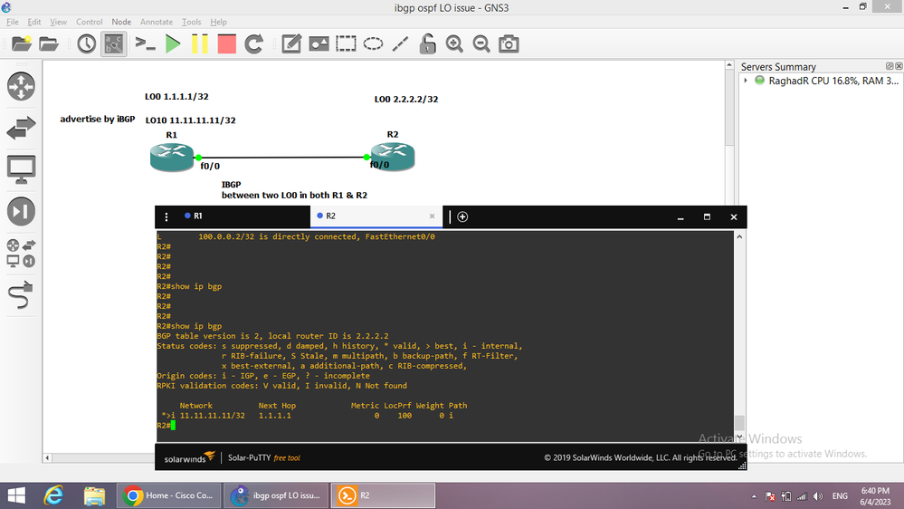

the OSPF (underlay) run ospf and exchange LO0 (using by iBGP as update source) between R1 and R2
after we establish the iBGP (Overlay) we can now advertise the LO10 through iBGP ONLY
