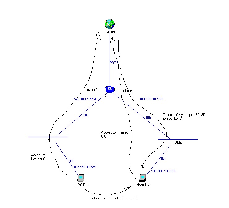

Hi, I've searched for a router that supports a connection through en ADSL. so I've choosed the 837 model. (If any other propositions, they are wellcome) How many interfaces has the 837 model. I wont to configure the router that it connects to Internet via the ADSL, and on the other side that I have 2 LAN or a LAN and DMZ. So it has a public IP, IP1-100.100.10.1, IP2-192.168.1.1. So i can forward som ports from the publis IP to the IP1. In this case my IP1 is the DMZ zone, IP2 the LAN. Is it possible to do this with this model? I've seen that it has four port manageable switch, but i didn't find the in the specification can it have 2 interfaces to cofigure them separately like:
interface Ethernet0
ip address 192.168.0.1 255.255.255.0
ip nat inside
interface Ethernet1
ip address 100.100.10.200 255.255.255.0
ip nat inside
Here is a picture of what i want do do, in case i was not clean... Sorry for my bad Englis too...
Thanks a lot!

dont think this is possible since there is only 1 routed ethernet interface on the device. the other ethernet interfaces are switched only.

I would suggest going with a higher line 870 series router. With the 870's, you can create multiple VLAN's and routed VLAN interfaces. With an 870 series, you'll be able to do what is indicated in the diagram. You cannot do this with an 837.

The 837's switch is, um, partially managed. You can set up a DMZ port by configuring special interface ethernet2, which separates switch port 1 out into a routable DMZ interface (ethernet0 is the aggregate switch interface.) However, there are some limitations on throughput which I can't remember the details of; you may want to search cisco.com for "837 dmz".

I have an 837 and you can do exactly what you are talking about. You will have 3 routed interfaces, 2 physical and one virtual. Interface E1 is tied to ports f1,f2 and f3 on the 4-port switch and port f4 is tied to interface E2.
