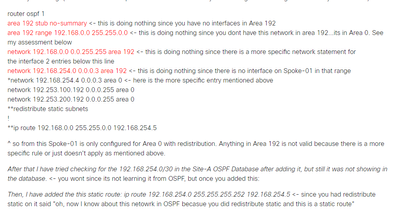

I have a question regarding OSPF point-multipoint non-broadcast setup. The links between Hub's & spokes are private links.
attached is the drawing with configuration files of Site-A with wan router-FW-Core Switch & Site-B with wan router-core switch.
The question is when typing
 #sh ip route | inc 192.168. on Hub-01 i see it as O E2 and #sh ip route | inc 172.16. on Hub-01 i see it as O IA
is this the correct ospf route i should see.

I assume you want O IA routes for both sites. IN this case (unless you need it that way) it wont matter much as there is only one site/path to get to the 192.168.0.0 network. The O E1, O E2 and O IA route preference come into play when its the same route.
To do what you're asking on Spoke-1 exactly I don't believe its possible (unless you do some very underhanded routing/policy with static routes maybe but I would not suggest that). As mentioned before the network command enables OSPF on that interface and advertises it onward with the mask of the interface. You cant separate it unless you want to run the routing protocol on the FW and the Core below.
Said another way you cant put the Spoke-1 interface towards the FW in Area 0 and the rest of the 192.168.0.0/16 network into another area unless you put a routing protocol on the devices below Spoke-1 (to be technically correct you CAN with some advanced tricks that even I couldn't say if it would work).
Another thought/question I had was I noticed your Spoke 1 interfaces were configured as P2P NBMA. Those need a neighbor statement on one side to form at least. We didn't see your HUB configuration, but my question is are you forming an OSPF adjacency with your sites or with he SP who is advertising your routes for you.
If you are peered with the SP in some sort of MPLS L3VPN then their configuration could also determine if the route was O/O IA/ OE1/2 etc. Just curious.
Without knowing exactly what's in that cloud troubleshooting can only got so far. Hope fully that can shed more light on the issue.
-David

The internal network being the 2 external sites? If that's the case then from your very fist output you achieved that. When you routes showed up as O IA and O E2 routes in Area 0 that indicates they were from other Areas.
If not then not sure what you mean.
Using different subnets/IPs have no affect on how your routes show up in OSPF (minus the loopback specialty case). Its how they are advertised into OSPF.

Thats what I mean when I said you lab is not the same so you cant compare your results to theirs. The OP does not have an ABR on Spoke 1, its an ASBR because there is redistribution static and everything else is in Area 0. Nothing is in Area 192, if you check my last post I explain it. So the Area range command is invalid for the OPs network. You would have to use the summary address command, but even that wont work since its still all in Area 0. It would take the O route no matter what due to OSPF routing preference. The reason they are is seeing it an an O E2 route is because there is a static route pointing to that prefix below the FW and its redistributing static making it an External Type-5 O E2 route.
And to be clear both spokes are NOT configured the same. One is configured as static and redistributed and the other is just a summary route. So the redistributed advertises O E2 and the Summary advertises O IA.
Also as mentioned the stub command is invalid because all networks are in Area 0.

I did check . It works for YOU because you have interfaces in 2 different areas making your device an ABR. The OP does NOT have this setup so its invalid. Their device is an ASBR with the route not originating in the Area...that's why the O E2 is seen.
They would need to reconfigure some things to make it work.
I agree with that. But this is not the case for the OP as I have mentioned. If you look at the config of Site-A Spoke router you will see it is NOT an ABR as the interfaces are only in 1 Area...Area 0, so the area range command is invalid. I explained this in my earlier response.

Yes. That is the old config. I was basing my assessment of the newer config from the OP where all networks are in Area 0. No longer an ABR. The Area 192 commands are obsolete.
