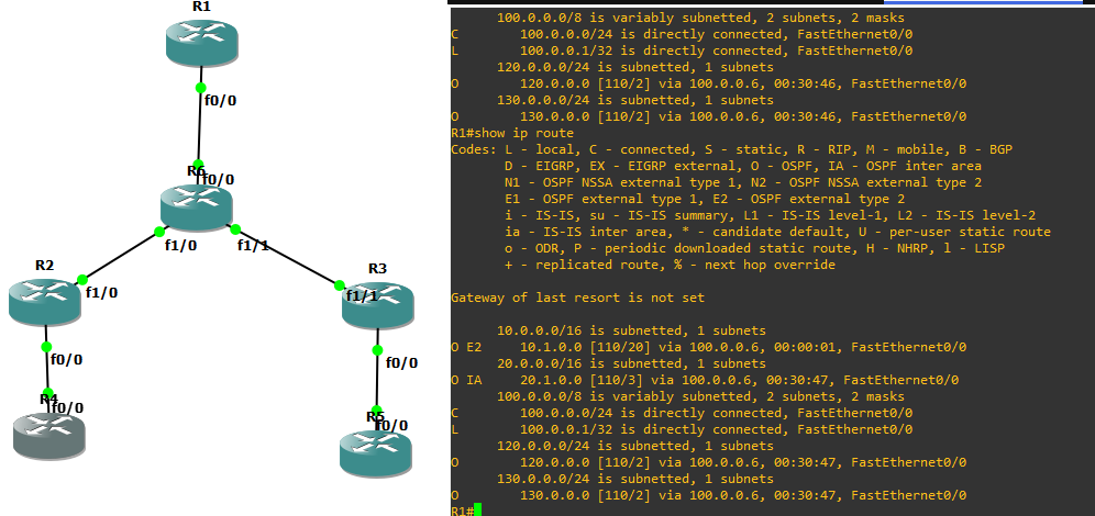

I need to see the tunnel config
can you share it ?
There is no tunnel configuration, this is direct connection (Point-2-Multipoint).
The configuration on the Service Provider is not feasible to us.
I will run lab to see the what exact happened.
I dont think it relate to redistribute static, but let me check first.

I run small lab (not exact IP subnet but same topology),
now return to your network
area 192 range 192.168.0.0 255.255.0.0 <<- this must advertise the 192.168.0.0/16 to Hub1+Hub2
and then advertise static route, but why static route is advertise and the O IA is not advertise??
 the answer for this Q is the 192.168.254.0 <<- this prefix is missing in OSPF database and hence the range is not advertise and static route is advertise.
so check ip ospf database for 192.168.254.0/30 <<-
