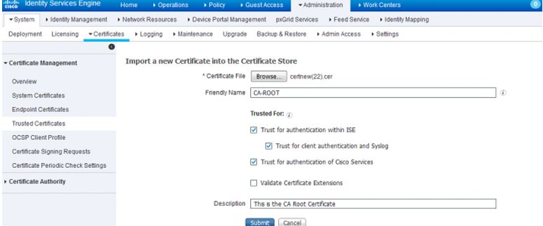

Login to your ISE node and navigate to Administration>System>Certificate>Certificate Management>Trusted Certificates and click Import:
On the next page, upload the CA certificate that you just download. I like to give it a friendly name that makes sense to be and a description that explains what the certificate is - adding this kind of detail is always good for the other ISE administrators that might get left managing this later on. I check the boxes next to:
  • Trust for authentication within ISE - This will all you to add new ISE nodes as long as they have the same trusted CA certificate loaded to their Trusted Certificate store.
  • Trust for client authentication and Syslog - You would check this box if you want to use this certificate to authenticate endpoints that connect to ISE using EAP and/or trust a Secure Syslog server
  • Trust for authentication of Cisco Services - You only need to check this if you want this certificate to be trusted for external Cisco services such as a feed service.
