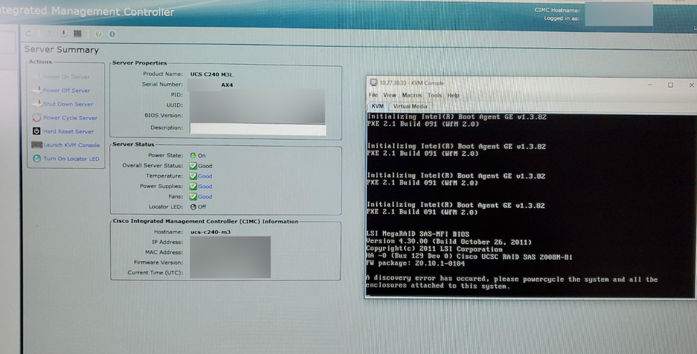

Didn't have a chance to setup UPS, but the power went out and the server was turned off.
error before I removed power supplyerror before I removed power supplypower supply #2 showing errorpower supply #2 showing error
For some reason after I turned back on it keeps saying:
Discovery error has occurred, please power cycle the system and all the enclosures attached.
I've power cycled it 10+ times, nothing changed.
Also, when I turned it on for the first time it was saying that the second power supply was faulty or not working properly, and I thought that was the issue. However, after I removed it I got a good overall status but still the same error text.
after I Removed power supply, error persistsafter I Removed power supply, error persists
Any advice or help is appreciated, thank you in advance

I believe that error is generated by the SAS raid controller, and could be a problem with the controller, SAS expander, backplane, etc.
To confirm that you may want to try removing the 2008 mezz card, temporarily to see if that error goes away (of course it won't completely boot, as local disks won't be seen)
You might want to attempt running the HUU firmware ISO with the controller reseated, and possibly with sas cables disconnected, if you can't proceed past that specific error message, and see if the controller's firmware can be reflashed.
Kirk...
When I unplug the sas cables it boots up fine and passes the error, no drives detected (obv).
If I only plug in one cable, I remove each and try to boot but the same issue as before.
I thought it was the card so I switched it out for identical one and had same issue as before.
When I tried plugging it directly into the mobo, I booted fine with no drives detected.
I also tried hard resetting the server but nothing happened.
Running the HUU
update finished, got new look but same error.
Suspect that is a communications issue involving the sas expander.
You might want to check the SAS cable and the expander ports to see if any pins are bent, etc.
This issue is likely hardware, and may not be easily resolved without component replacements, which is a difficult task, given the EOL/EOS status of the server.
