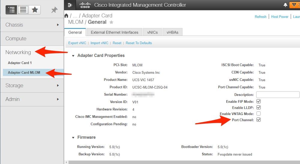

Can you confirm the adapter settings from the CIMC? Do you have "port-channel mode" checked?

Where would I find the port channel mode setting? I can't find anywhere to see or change any of the VIC's settings.
From the CIMC:
Can you tell I haven't touched the CIMC on a stand-alone UCS box in about 5 years? Lol, I found it. Thank you!
