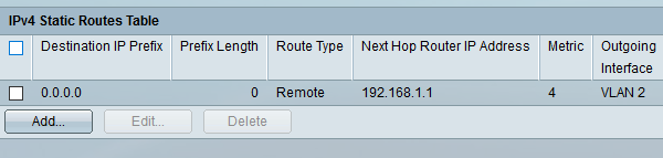

I'm trying to configure a SG350-52P (my first time...), running with the latest frimware.
I've configured 2 VLAN. I want to use VLAN1 for all the PC of the office and the other for the router.
Only one interface uses VLAN2 (GE24)
I've also configured a DHCP server for the VLAN1:
These are other IPv4 configuration screenshot:
If I try to test the interVLAN routing it seems to not completely work.
I can ping the interfaces of the two VLAN
and from VLAN2 I can ping the router:
But I can't ping the router (and aslo reach internet) from VLAN1 and also from my pc with add 10.0.0.50 in VLAN1
I've read other discussion here and I've tried to solve it but unsuccesfully.
I attach also my configuration
Do you have any idea to solve this issue?
Thanks in advance for your help.

Seb Rupik
Hi there,
the router probably doesn't know how to reach VLAN2. It will need a route like:
10.0.0.0 255.255.255.0 192.168.1.11
ie, VLAN2 is reachable via the SG350 VLAN1 SVI.
Regarding reaching the internet, the router will need to be configured to NAT the 10.0.0.0/24 subnet. On cheap ISP routers it is highly likely that you will not be able to configure this.
cheers,
Seb.
