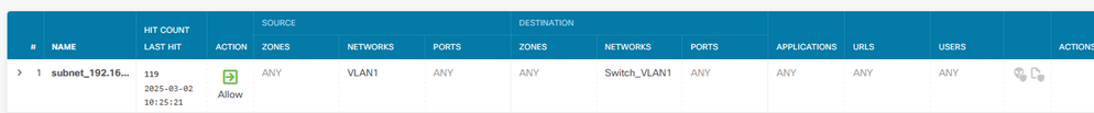

ACL on FTD (not sure if necessary)

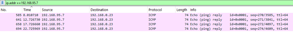

Hi M02@rt37,
I did a packet capture on my FTD.

 This is identical to what I recorded with wireshark:
During the http request from PC 1 to PC 2 I captured the following traffic:

What I find interesting is that the ping from PC 1 to FTD (Port 4) captured both - response and request.
In contrast to the ping from PC 1 to PC 2 where the request is missing and just the reply was captured. But is this something to worry about?
