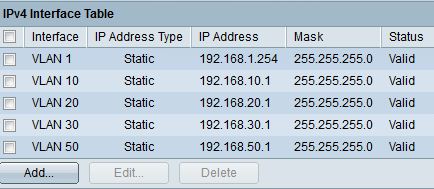

On my cisco switch/router i have created 4 vlans, using the below interfaces
192.168.1.254 if the ip address of the switch
port 1 which is vlan1 is connected to my Netgear WDNR4500 Wirelss Router
The remain ports are connected to seperate network cards, on my VMWare Esxi host.
When i create VM's within each individual vlan communication is fine and i can ping vms on the different vlans,
My issue is i do not get any internet access from any device connected to the specified vlans, except for vlan1
If i ssh into my switch i am able to ping my isp's dns servers 194.168.4.100, but from all other vlans its not possible.
Not really sure what i have done wrong or what i need to get internet access for my vm's.

Hi Jitesh, that is correct behavior. The default gateway need to be the vlan interface Ip address.
If vlan 20 is 192.168.20.1 then any machine connecting in vlan20 gateway should be 192.168.20.1

Make sure the clients in VLANs 10,20,30, and 50 are using 192.168.1.254 as their default gateway. Also be sure the switch has a default ip route that points to the router supplying the internet access (but it sounds like you have that bit working, since VLAN1 has internet access). Finally if you have traffic NATing in from the internet that needs to reach one of the VLANs, add static route(s) on the edge router to point back to the VLAN, e.g.
ip route 192.168.30.0 255.255.255.0 192.168.1.254
