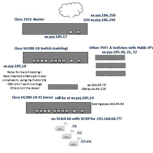

They say picture worth a thousand words (even if a bad one, my apologies), but here goes:
so here's briefly what I'm trying to accomplish....(see above)
I have a network on a Comcast fiber with public static IP's ..I have a cisco router 1921 up front, then a cisco SG300-10p switch to handle traffic connections between my internal network of computers (behind firewall), the VoIP phone system, and another 3rd party data network....all those pieces are all functioning just fine.....
Now I need to add Wireless "guest" network to the mix, separate and outside of the firewall (and any internal business systems). Were going to be using (5) Cisco WAP321's (PoE) ...each location has been cabled with a home run back to patch panel. My plan is to use another 2nd Cisco SG300-10p (new, on the diagram)  to be the central switch and power supply for the WAP's ...I've changed that switch to L3 (as router) and have setup a 2nd VLAN and have added 5 ports to it (one for each WAP), but what I would also like to do is have those 5 ports also have a DHCP server to manage assigning IP's (like a 192.168.40.xx or 10.10.10.xx etc) ....(so to have a VLAN across 5 ports of the SG300 and handle the DCHP for the WAP's (to simplify WAP setup, since they all be hanging 12+ ft on the walls...and be my power source and my gateway...all as a nice neat package). I will use 1 one the public static IP's we have for 2nd SG300 and point it to the Cisco 1941 as the network gateway.(like my 1st SG300-10).... but I seem to be stuck....I can't seem to find where to set the DHCP and IP ranges for the VLAN? I want the "Guest" access to be seamless as people wander through the building while using the Wireless access to the INET (totally outside the office Firewalled apps etc).
So right now I'm a bit stumped...can I do this? does each WAP have to be a separate VLAN?? as it's own static address?? Seems to me I could just do this with a series of regular wireless routers, bridges/boasters etc...but everything in this network is "business class" so was thinking this would be a more robust solution, but the programing is stumping me (fyi been trying to do via the Cisco Web Browser interface,or do I need to program manually via Console like I had to do my Cisco 1921??)
Can someone point me in the right direction here? (or have some examples or same code to refer too). I feel I'm close, but still a bit new to some of these business class devices, and seem to be missing couple of key pieces.
Thanks in Advance!
George

Hi Andy,
Getter closer now ..perhaps you can help me resolve my final (I hope) issue...
I've included diagram and latest Config of where I'm at and also the sh ip routes info.
(1st I'm testing in my office on my network, which I've done many times before build these config's before. Actually the whole front end on my diagram was config'd on my bench 1st....this is not my issue).
Ok I've got the "new" SG300-10 #2 up and running at least for normal type traffic ...that is I've left the first couple ports setup "normal" ...meaning that when I plug in my laptop, I get an IP (aa.bbb.84.82) from DHCP from my router which I expected to happen and I have Internet Access - perfect.
Now I have VLAN 60 setup (only on ports 4 & 5 for testing), with DHCP attached to it for network range 192.168.60.???.  When I connect my laptop to one of those ports I get an IP assigned (192.168.60.50 as expected) and seems to pickup as GW 192.168.60.1 ...again as I expected and wanted. BUT from those ports I cannot access the internet (can't ping anything other than 192.168.60'S)...no route outside??
Now from within the SG300 (have Telnet access) ....seem to be able to ping internal and external addresses no problem.
So it seems I have no route from the VLAN  60 to my Gateway (which is ultimately at aa.bbb.84.126 of my DSL service. I have 64 public ip's)
I had a similar problem with a Cisco router once and was just missing an ip route call.....my issue now seems very similar. Really seems I'm just missing something (hopefully simple)? Can you help me with this please?? I really need to get this up and running now (I can't believe how long I've been at this).
Please let me know if there's any addition info you need that I may have left out.
Hope to heard from you soon. Thanks so much for your time
George
