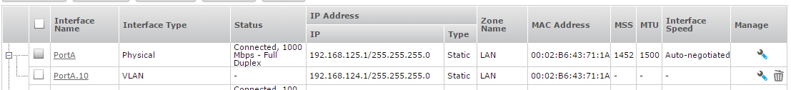

Cyberoam CR100iNG:
The problem is that when I connect to SSID I don't even get IP address from DHCP for that VLAN.

To check if it is an issue with the switches, could you configure a Layer 3 interface on the SG300 and have it get an IP from the DHCP server? Also, I noticed on the CyberRoam that the interface status for the virtual interface is blank (seems like, per CyberRoam documents, it should show "Connected" with speed/duplex information). Can you please check the CyberRoam to see if the VLAN interface is setup properly? Also, you could try configuring one of the CyberRoam interfaces in the said VLAN, set the corresponding interface on SG300 as an access port, and try to see if that helps?

You have sharp vision. Yes the interface for VLAN does not show Status as Connected. It's something I have contacted Cyberoam support to resolve. They stated it's old documentation and that VLAN interface does not show Status since newer firmware releases.
Since client that connected to GE9 on SG300-10SFP got IP address for correct subnet 192.168.124.0/24 I think we can be safe that Cyberoam part of configuration is correct and that SG300-10SFP is also correct. Now I have to check SG200-26 configurations again.
