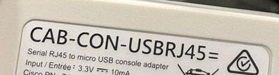

Cisco does make this adaptor, I don't know why this is not included in these switch boxes.  I have received similar adaptor with a different cisco router model. Attached is an image of the adaptor I have receivedmicro usb type b console.jpeg
Where do you buy CAB-CON-USBRJ45 ? Wherever I go I just see a regulare USB cable not the dongle style micro USB to RJ45 serial. Perhaps all these sites have the wrong pictures up or Cisco has the same part number for 2 different parts? Let me know if you actually purchased this part. A picture would be helpful.
you buy this from cisco, reach out to cisco sales rep and order this directly from cisco

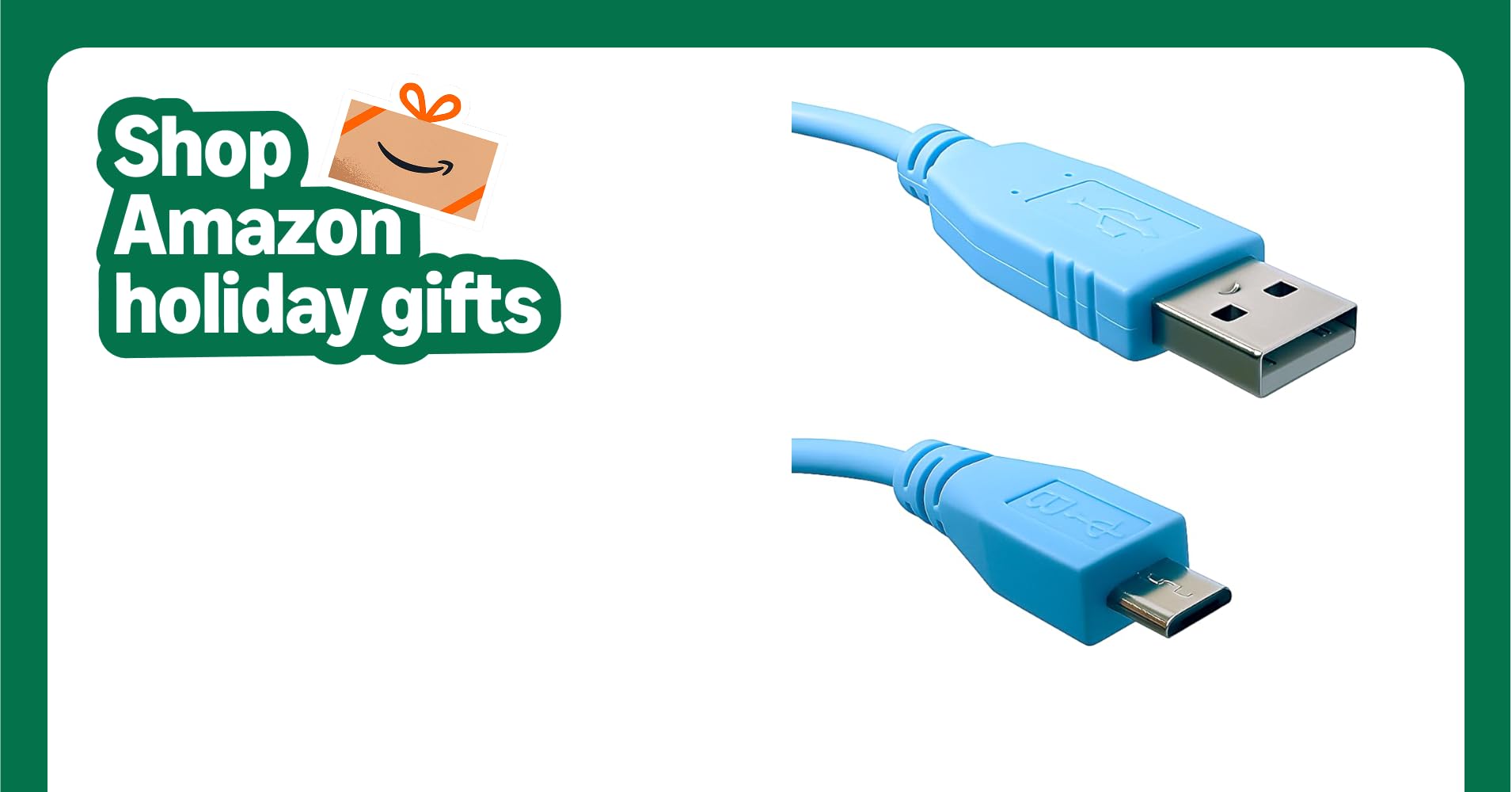

search Amazon for Cisco Console Cable | USB Type A to USB Micro-B 6 ft (1.8 Meters) | CAB-USB-UB= | USB 2.0
$29.95 works without adding drivers to windows 11 on the C9200CX
alfred_tong
This is the correct cable you should be looking for
https://www.amazon.com/Aexus-Console-Micro-B-Meters-CAB-USB-UB/dp/B0CTGMN329
