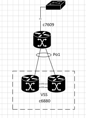

The problem:
We have about 1500 access switches with managment vlan.
Network scheme is attached below.
ARP aging time is not reset to zero with existing traffic in management vlans. We have OpenNMS which pings hosts every minute + takes readings via SNMP. After the time expires (4:00 hours), the arp entry disappears and the host becomes inaccessible from 5 to 60 seconds, after which the arp entry reappears.

What could be the problem?
