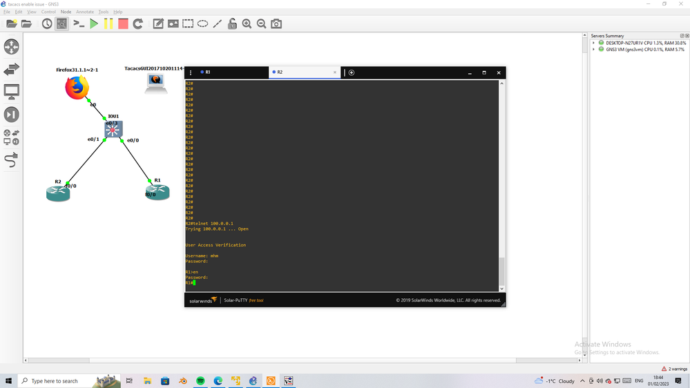

I will lab check one solution
I will lab to ensure that change the config not effect access to SW/R via console or vty.
please wait my lab
thanks
aaa authentication enable default group radius local <<- first I dont see local in cisco command reference, please check command
second
R1
enable password ciscolocal
aaa new-model
aaa authentication login default group tacacs+ local
aaa authentication enable default group tacacs+ enable
ip dhcp pool mhm
network 100.0.0.0 255.255.255.0
username mhm password 0 ciscolocal
interface FastEthernet0/0
ip address 100.0.0.1 255.255.255.0
duplex half
tacacs-server host 100.0.0.2 key cisco
line vty 0 4
this test
use local username and password for login auth
use enable (local) password for enable
use tacacs username and password for login auth
use enable (tacacs) password for enable
