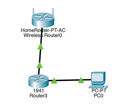

I need help to configure this setup
I have a 1941 Router and i want configure bridge between PC (FastEthernet0/1/0) and Home Router (GigabitEthernet0/0), has any posibilitie to make this functonaly ? How i can configure my 1941 ?

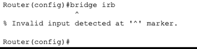

Thanks by your message but unfortunately this Router apparently don't have "bridge irb"
am I doing something wrong?

Packet Tracer may simply not support the bridge function. This is not a full IOS simulation, there are some commands it does not support. Instead of Router3 1941, does a Switch should be sufficient for your topology ?

I think...It is the problem with packet tracer itself.....
Packet Tracer may just not support the bridge function. It is having some limitations.... there are some commands or feature it doesn't support....
Yes...it works on real router.....you can also try with gnsv3 if possible.....

The above "bridge irb" commands are for real gear, real router; PT is just a simulator with limitations as mentioned above; however, the alternative configuration is to by pass router itself; this works in both PT sim and real router. Since 1941 Routers support Ethernet switching module, you just use it; Ethernet switching module for routers is just like a l2 switch; it can be as switch and communicate with router itself or as l2 stand alone switch using any vlan number other then vlan 1.
Connect PC and your Home router to ports in switching module of router 1941 but not to build-in physical router ports.
Here is working sample; Note that PC got IP from Home wireless router and R1941 is not configured at all.
Note: bridge irb method mentioned above is the only way to bridge network for routers that do not support Ethernet switching module (simply not available in all models)
Regards, ML
