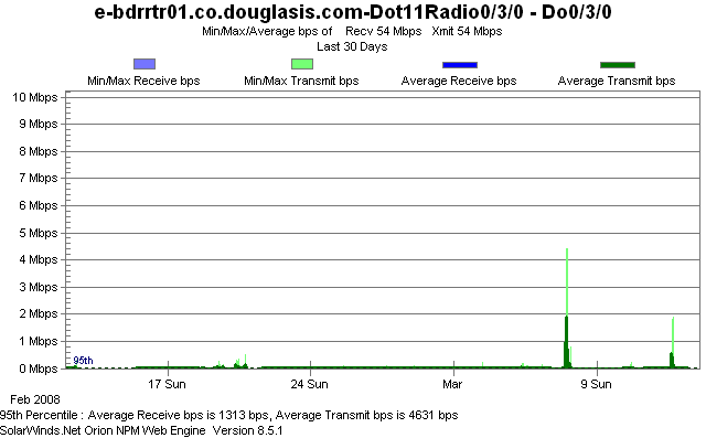

Hi Edison,
OK, here is what I'm doing... I have a dedicated T-1 to the Internet and a DSL line. This router has a service policy on the the Internal Ethernet Interface that route-maps critical traffic out the serial interface. It just so happens the snap shot I took of the serial interface someone was uploading a large file through an IPSEC tunnel. This is not always the case as you can see from the attached throughput chart on the serial interface. Traffic like HTTP/HTTPS traffic will default out the DSL Path. The dot11 interface services all visitors locally here with Internet connectivity out the DSL. As you can see not much happens on the wireless visitor, but it sure seems to need lots of buffers.
thanks,
scott
