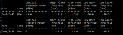

I have a stack of 9500s with a link down to a 3750 via fiber.  Started seeing some issues with video choppiness from equipment connected to the 3750.  Looking at the link side on the 9500 I see a fair amount of input/CRC errors and after changing both the SFP and fiber patch to the patch panel it made no difference.  I see low power level alarms in the logs on the 9500 side as well but nothing on the 3750 side which is clean.
Is it safe to say something in the path is bad?

Describe the physical link.  Is this a single patch cable or is there a horizontal cabling plant involved?
9500 SFP > fiber patch cable > fiber patch panel > fiber run down to 1st floor > patch panel > fiber patch cable > SFP 3750.
Use a different pair of fibre.  The line errors are significant and points to a Layer 1 issue.  If using a different pair of fibre plant to the first floor works, then get the original pair investigated for a potential break in the glass.
I figured as much.  Thanks for your help.
