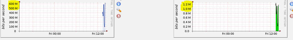

Hello, configured an Exagrid backup appliance with two nics in bond0 and appliance states 802.3ad is the mode.
These two links are connected to a 3560-X switch and Port-channel 12 was defined.
I ran a backup job and monitoring the traffic graphs I see that one of the nic's is barely used, while another one is carrying the bulk of the traffic (500mbps+).  Also doing a bps command on the backup server only seems to indicate one nic is receiving the backup traffic.
