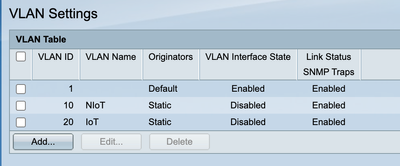

New to networking, testing at home lab trying to setup 2 VLANs on Layer 3 enabled SB500, VLAN setup seems fine but I cannot ping the gateway/firewall from the switch and cannot got in the internet from either of the 2 VLAN I created. Can someone point me in the right direction? I seem to be missing something basic n the setup that I could not catch in all the forum posts I read through and the youtube videos I watched trying to setup Layer 3 routing and VLANs on the switch.
for simplicity, what I am trying to do is setup 2 VLANs on L3 switch SB500 and have internet connectivity from both of those VLANs and intervlan connectivity without going through the gateway (not looking for router on the stick setup)
Network:
Unifi Dream Machine Pro (Gateway Router/Firewall) (192.168.1.1)
Cisco SB500 in L3 (vlan1 192.168.1.235)
Created VLAN10
Created VLAN20
Interface GE1 - Access, untagged - PVID10
Interface GE2 - Access untagged - PVID20
Interface GE24 - Trunk to Dream Machine Pro
IPv4 Interface for VLAN10 192.168.10.1
IPv4 interface for VLAN20 192.168.20.1
I have also enabled DHCP for both VLANs and setup Network Pools
At this point, I can connect PC1 to GE1 and get an IP from DHCP on the switch, I can access the switch via 192.168.1.235 and via 192.168.10.1
I can SSH on the gateway router (Dream Machine Pro) and I can ping Vlan1, Vlan10 and Vlan20 IPs
I cannot however ping the gateway from the switch, neither can I go on the internet from VLAN10 or 20
Am I missing a static route on the switch and/or on the gateway router or am I missing something else? if I try to get on the internet, Chrome just says at the bottom Resolving Host, I tried IP of yahoo.com but still no go.

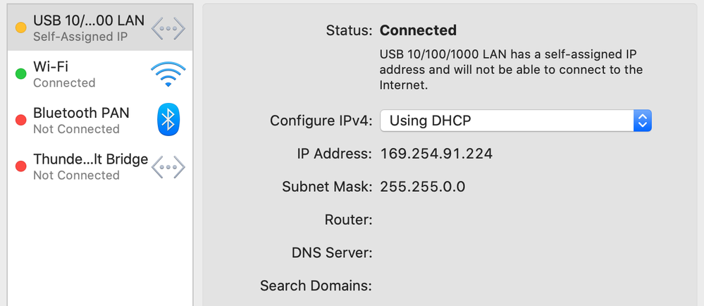

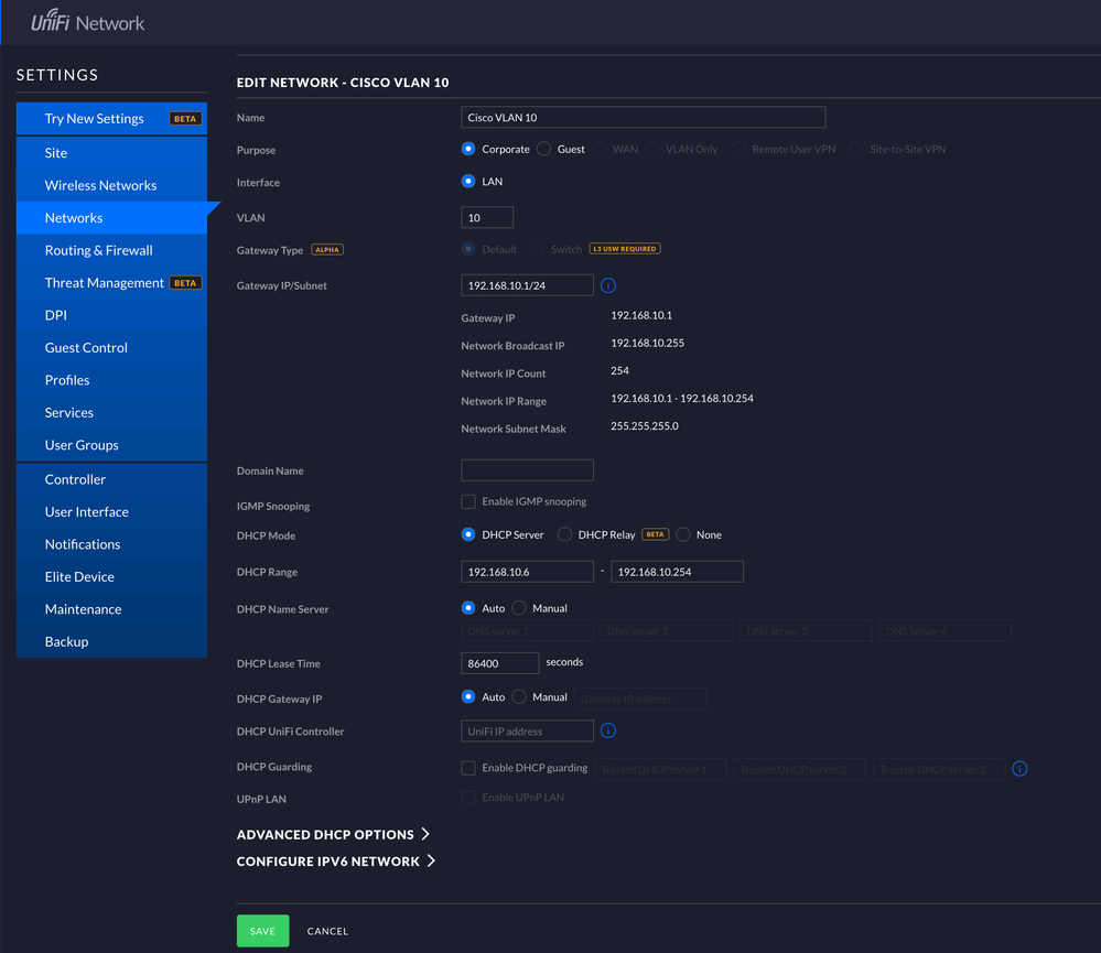

I followed the steps from the video but I am getting a self-assigned IP on the computer connected to VLAN10 port  instead of IP being assigned from the Unifi Dream Machine Pro.
Do I need to enable DHCP relay on the switch?
