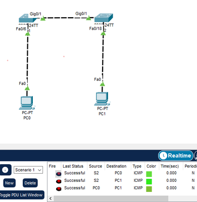

I've encountered issue as the Cisco Switch 2960 (configured as S2) in the lab does not response to ping.
PC-A can ping PC-B and S1
PC-B can ping PC-A and S1
S1 can ping PC-A and PC-B
S2 failed to ping S1, PC-A and PC-B
S1, PC-A, PC-B failed to ping S2
It looks like to be S2 become a ghost device.
I followed the lab instruction to configure all devices.
Attached please find the package tracer for reference.
Any insight would be greatly appreciated

it seems to be ok, all pings are fine after first 2 fail; remember before u can ping, ARPs must be resolved
u must give some time for switches /PCs to build ARP and MAC tables
Regards, ML
**Please Rate All Helpful Responses **
Thanks for your information.
I've no problem in packet tracer. But I have problem pinging S2 in the same setup in actually lab in school.
