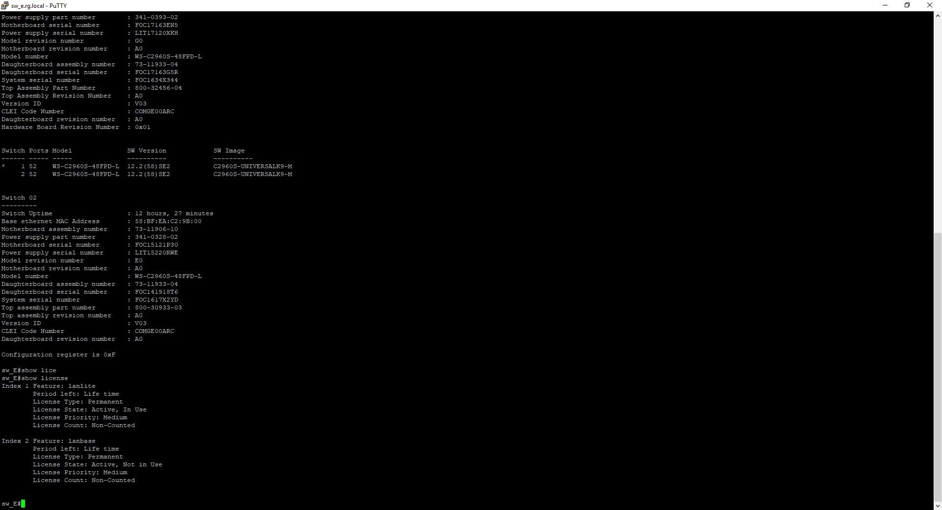

I have a problem. I have two switches 2960s (stack) with two installed licence - Lanlite and Lanbase. Lanlite is active.
How can I change lanlite to lanbase?

The problem is that I have a switches Catalyst 2960-s Series PoE+10G. Model's numer is WS-C2960S-48FPD-L.
Two days ago I contacted with cisco support about the wrong version of the license. Cisco enginer sent me a new licence - lanbase. I installed that but I don't now how it activate.
At now I have two licences at my cisco: active, in use lanlite and active, not in use lanbase.

How I got the switch from the lanlite license, which should be a factory lanbase license?
I have a situation that I bought a WS-C2960S-48FPD-L switch with a pre-loaded lanlite license. Someone in cisco made a mistake by uploading this license and now I can't do anything about it?

Thanks for the answers and explanations. I bought the switch from 10 years ago so the complaint is hardly an option. I will have to replace it with a new version. I counted that I can somehow change the license. Thanks again for help.
Yes its not the best answer but im in same situation i have an old 2960 lanlite wont support any ISE commands i need to remove it too as i cant upgrade it either
