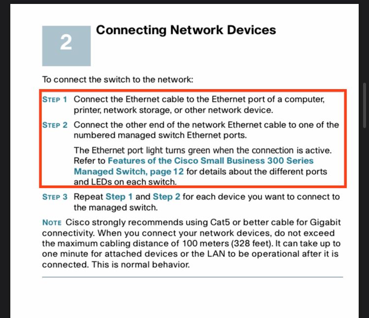

Hi @jord9857
Check the guide:48A89FD3-F710-4D83-A635-88F0034EECB5.jpeg
Regards
