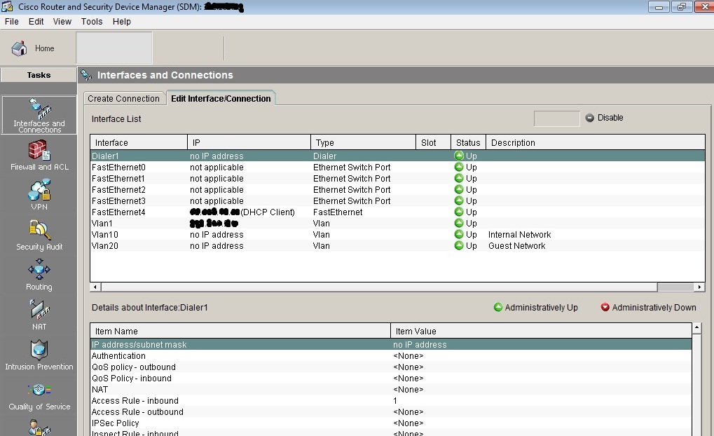

And i also have NAT configured and my laptop can see the connection area is marked as like i'm connected to the internet but i can't do nothing
Iv'e added a screen shut that show the configuration and it says that the WAN port is off but it's not.

FastEthernet 4 is WAN port on 871 and it should be connected to your ISP device.
It is currently up/down.
NAT and other configuration are good.
you need to bring up FE4 interface.
How do you connect 871 to your ISP? Cable modem?
KK
FastEthernet 4 is WAN port and it was connected to the cable modem and i got connection after potting the port on but i was unable to get any internet service http or im or anything.
