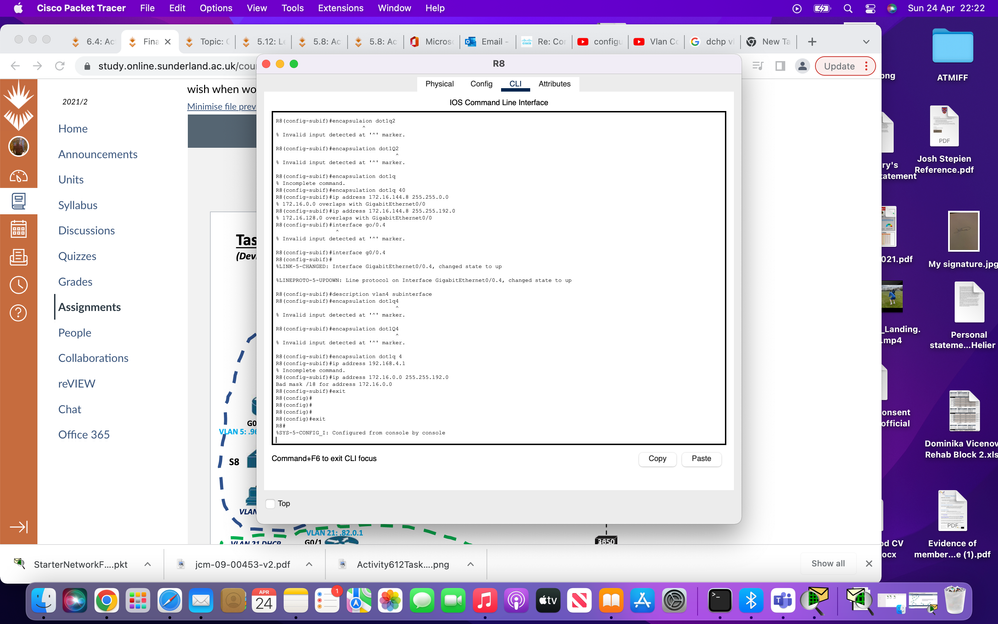

Correct me if I'm wrong but am i typing the incorrect subnet mask here to encapsulate my router to access VLAN 4 addresses? I have used the VLAN 4 subnet I.D but says it is overlapping? Thoughts please?Trunk encapsulation.png
For some reason I did not see any file. Can you attach here please.
Thank you for your response.
I have established I need to create subinterfaces on my router for VLAN's.
However when I enter VLAN ip and subnet it rejects it.
Thoughts please?
The IPs you are entering are the subnet addresses ie. 172.16.64.0 and 172.16.128.0  which is why it is showing an error.
Use the first IP address available ie. 172.16.64.1 and 172.16.128.1 (or any other IP from the subnet if you want).

When i assign different subnets, it suggests my mask is overlapping with go/o but I have adjusted this?
I have attached 2 screen shots, one with an overview of the task and the latter my coding.
You seem to have posted the same as before ie. you have not updated the IPs you are using.
What is the IP and subnet mask on gi0/0 ?

For example i used a different ip address but same subnet as VLAN public address /20 but states it overlaps with 172.16.64.0 /16 gigabitethernet 0.0. However that IP address is 172.16.44.9 /16.

Can you just post the IPs you are trying to use with the subnet masks where it is saying they are overlapping.
Jon
IP addresses
Network IP 172. 16. 0.0 /16
Vlan 2 172.16.128.0/20
Vlan 3 172.16.64.0/19
Router Interface g0/0 IP 172.16.144.9 255.255.0.0
Router interface g0/1- Trunk port-Subnet I.D's  Vlan2:128.1 Vlan3: 64.1
I have coded the following:
interface go/1.2
encapsulation dot1q 2
ip address 172.16.128.3 255.255.240.0
then says....
172.16.64.0 overlaps with gigabitethernet 0/0
Thoughts please
Yes because gi0/0 is 172.16.0.0/16 which covers both 172.16.64.0/19 and 172.16.128.0/20.
So you need to change the subnet mask of gi0/0 if you want to use 172.16.x.x IPs on all the interfaces eg. /24 would be fine but there are a lot of options you could choose.
Jon
Thank you for your help. Problem solved.

Thank you Georg for your response.
Following your guidance I still failed to complete a DHCP.
I used the default VLAN 4  address  172.16.0.0 255.255.192.0
